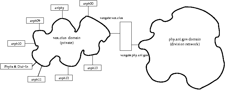

If you like diagrams, here's a logical view of the private network in relation
to the division network.

The Gateway
In addition to these nodes, there is a gateway machine which bridges the
private network to the Physics Division networks and to the wild wide Internet.
The name of the gateway machine is vaxgate.phy.anl.gov on the division
network and vaxgate.vax.clus on the private network. Connection
to the gateway from the Internet is possible only via ssh. Once you
are logged into vaxgate, you can use telnet to connect to the Vaxes.
Conversely, if you are logged onto a Vax machine and wish to reach the
outside world, you must first log onto the gateway. In this case,
you telnet to the gateway from the Vax cluster.
The gateway is part of the maria cluster. You will need an account
on the maria cluster in order to log onto the gateway.
