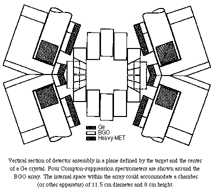

The Argonne-Notre Dame BGO Gamma-ray Facility consists of two main components: an outer ring of 12 high-resolution Compton-suppressed Ge spectrometers (CSS) surrounding an inner array of 50 BGO elements with high gamma-ray stopping power and detection efficiency. These two figures show horizontal and vertical sections of the detector assembly.

The inner array is designed for bulk-property measurements of the [gamma]-ray spectrum (sum energy and multiplicity), i.e. this detector has to have a relatively good multiplicity resolution and sensitivity which is achieved with large solid angle coverage and good granularity. The array covers 78% of the 4[pi] geometrical solid angle around the target with 50 hexagonal elements. Each BGO element has a typical energy resolution of 17% (for 661-keV gamma-rays emitted from a 137Cs source) and a time resolution of 3 ns (measured with a 60Co source). The configuration of 50 separated BGO elements provides a sensitive measurement on [gamma]-ray multiplicity. For example, the measured multiplicity distribution for 30 [gamma]-rays, each of 1 MeV, peaks at 22.3 and has a resolution (FWHM) of ~5.5 (23%).
For the high-resolution photon energy measurements, in order to achieve high resolving power, the sensitivity of each individual Ge detector needs to be improved over that of a bare Ge crystal. In the BGO setup, the Ge detectors with BGO anti-Compton shields typically yield a peak/total (P/T) ration of ~0.62, compared to a P/T=0.18 for unsuppressed mode (again for a 60Co source). This improvement is further amplified in high-fold coincidence measurements: the fractions of events in full energy peaks for two-fold and three-fold coincidence measurements follow a (P/T)n law and will be 0.38 and 0.24, respectively; the corresponding values for bare Ge detectors being 3.2x10-2 and 5.8x10-3, respectively. Twelve CSSs offer sufficient pair combinations and solid angle coverage for optimal two-fold coincidence measurements.
